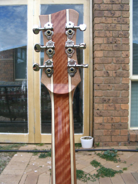

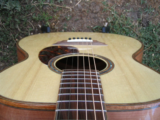

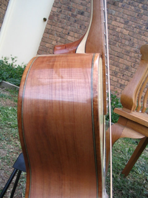

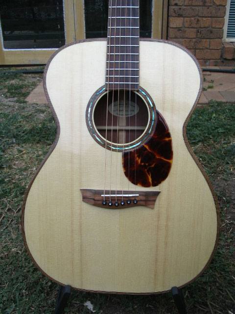

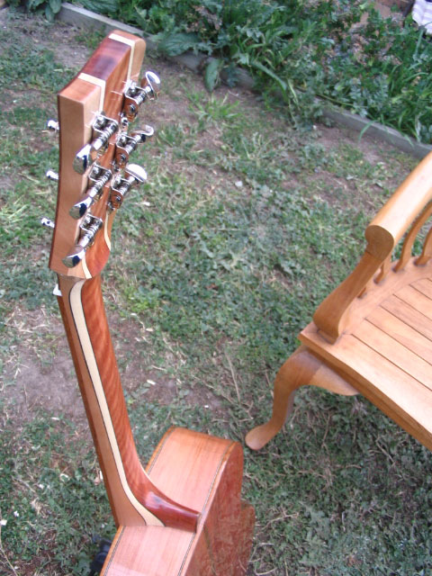

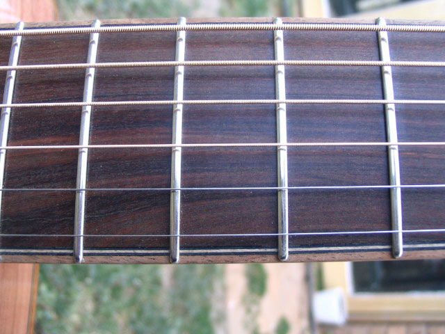

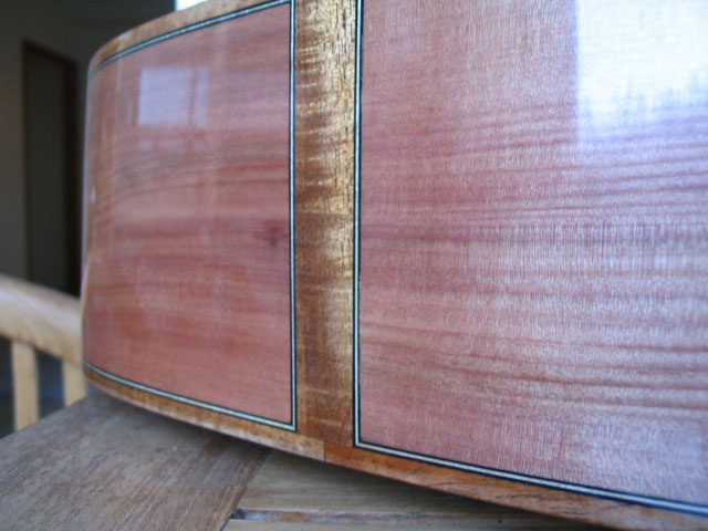

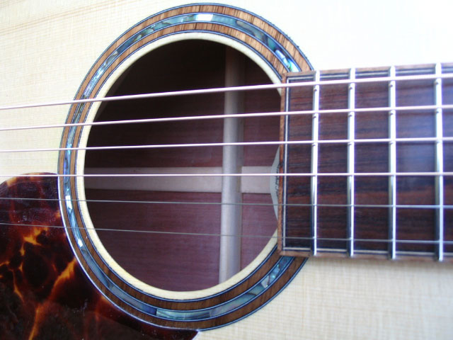

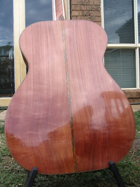

Finished off this one today and it's heading back from whence it grew.
I'm delivering this one in person next weekend with ulterior motive of spending a week in Tasmania perusing sawmills and timber merchants along the North West Coast and in Hobart. (and maybe a few Boags Premiums if I have time)
The lowdown and dirty on this one is
Tasmanian Myrtle back and sides, Blackwood bindings with an Engelmann Spruce top.
The neck is Myrtle, Maple, Jarrah with a Myrtle head plate.
The fingerboard is Mulga from Tim Spittle. Amazing wood with a hardness of somewhere between 13 and 18 (Ebony comes in at 9.5)and polishes beautifully.
The Myrtle is also wonderful wood to work with and changes colour from a pink to a rusty red depending what lighting you are in. Doesn't need pore filling either !! Beauty.
Dave's a bit dirty because he wanted to keep this one for himself after hearing it. It is very responsive with a nice resonant bottom end. The top was very stiff so we ended up making it quite thin.
Here's some pics and thanks for having a squiz.

a real beauty Bob!

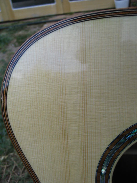

i see you just did something ive been thinking about doing - B/W/W/wood/B/W/B purfling scheme.
can you show the wood part of it a little better and perhaps elaborate on this a bit?

The Myrtle comes up very rich , and your purfling/binding is outstanding,,,,,not forgeting those nice tight mitres. Then there's the neck ! wow , and the rosette is perfect.

I like the way you used the Tas Blackwood for the bindings. That neck is wild!

Udi
The wood purflings were bindings sliced in half with a Stanley knife.
Here's a closer pic
Martin, Hesh and Arnt, it is Ubeaut Hard Shellac and it is the our standard 2 coat treatment. We are going to test a 50/50 dilution with 4 coats on the next instruments to get better flow out. ie reduce sanding time.

PostPosted: Sun Sep 23, 2007 8:44 am
Posts: 214
Location: Israel
so its basically just 0.090" +- thick? just a binding strip that is half as tall as it "should" be, bent the regular way, and what we're seeing is its narrow plane?
i'm asking coz ive been planning on building a 00-45 style guitar but use wood instead of abalone for purfling on the top, sides,back,end grfat and heel.
and now that i've seen what you did, i think i might just go for it when time permits.
thanks!
Udi.
PostPosted: Sun Sep 23, 2007 10:07 pm
Posts: 698
That's right Udi. I think I took them down to .080 but in future I think .060 will give it a better look.
I didn't bend either the bindings or the purfling before I installed them on this one. (although I probably should have)
I just worked the bindings and purfs into the waist very slowly until it became pliable.
